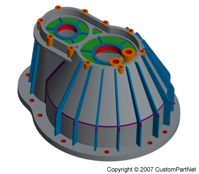

Most parts have a main solid body with numerous features that modify its shape. These features can usually be classified as depressions in the part or protrusions from the surface. There are also angles or curves that can be applied to the part. The types of features on a part often dictate which manufacturing processes can be used to form the part. However, sometimes one process will be used to form the main body of the part and additional operations will be used form the more complex features. When a feature is not formed by the primary process, it is typically referred to as a secondary feature.
Cast housing with highlighted features
