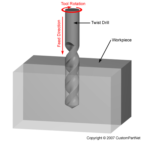

Drilling
A drill bit enters the workpiece axially and cuts a blind hole or a through hole with a diameter equal to that of the tool. A drill bit is a multi-point tool and typically has a pointed end. A twist drill is the most commonly used, but other types of drill bits, such as a center drill, spot drill, or tap drill can be used to start a hole that will be completed by another operation.
Drilling Operation

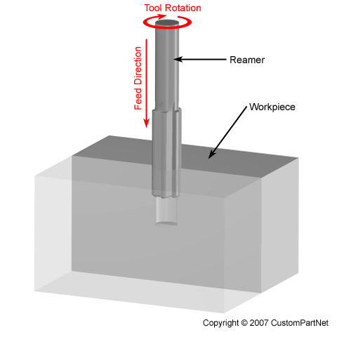

Reaming
A reamer enters the workpiece axially and enlarges an existing hole to the diameter of the tool. A reamer is a multi-point tool that has many flutes, which may be straight or in a helix. Reaming removes a minimal amount of material and is often performed after drilling to obtain both a more accurate diameter and a smoother internal finish.
Reaming Operation

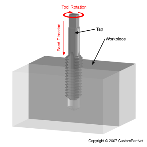

Tapping
A tap enters the workpiece axially and cuts internal threads into an existing hole. The existing hole is typically drilled by the required tap drill size that will accommodate the desired tap. The tap is selected based on the major diameter and pitch of the threaded hole. Threads may be cut to a specified depth inside the hole (bottom tap) or the complete depth of a through hole (through tap).
Tapping Operation

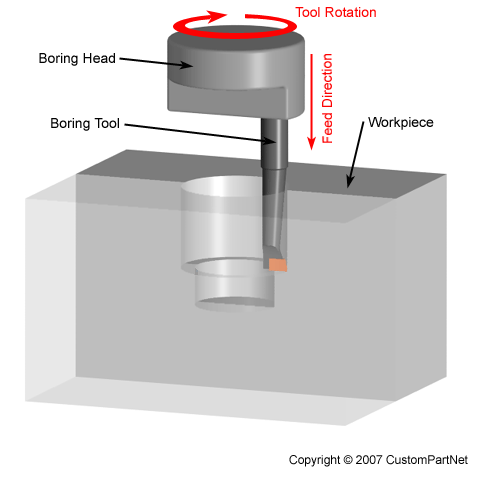

Boring
A boring tool enters the workpiece axially and cuts along the internal surface of an existing hole to enlarge the diameter or obtain more precise dimensions. The boring tool is a single-point cutting tool, which can be set to cut the desired diameter by using an adjustable boring head.
Boring Operation

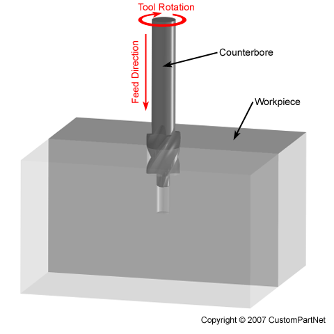

Counterboring
A counterbore tool enters the workpiece axially and enlarges the top portion of an existing hole to the diameter of the tool. Counterboring is often performed after drilling to provide space for the head of a fastener, such as a bolt, to sit flush with the workpiece surface. The counterboring tool has a pilot on the end to guide it straight into the existing hole.
Counterboring Operation

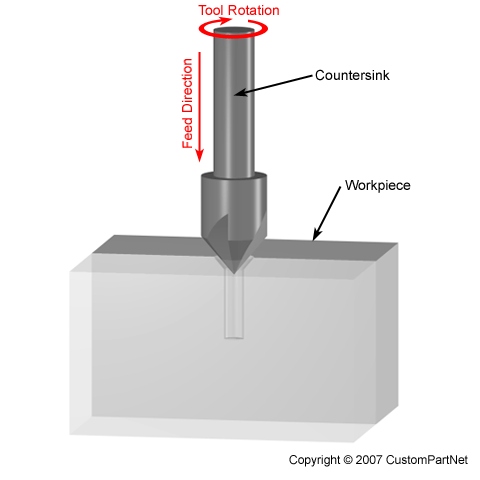

Countersinking
A countersink tool enters the workpiece axially and enlarges the top portion of an existing hole to a cone-shaped opening. Countersinking is often performed after drilling to provide space for the head of a fastener, such as a screw, to sit flush with the workpiece surface. Common included angles for a countersink include 60, 82, 90, 100, 118, and 120 degrees.
Countersinking Operation
