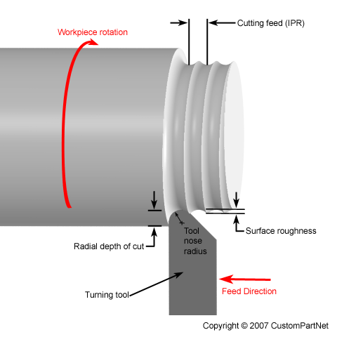

Calculate the surface roughness for a turning operation based on the tool nose radius and the cutting feed (IPR). Single-point cutting tools used for finishing operations have a rounded front corner, or "nose", which forms small peaks and valleys in the material as the tool feeds along the rotating workpiece. The height of these surface variations define the surface roughness, which can be measured as an arithmetic average (Ra) or an RMS value.

SURFACE ROUGHNESS DIAGRAM
Turning Surface Roughness Diagram
