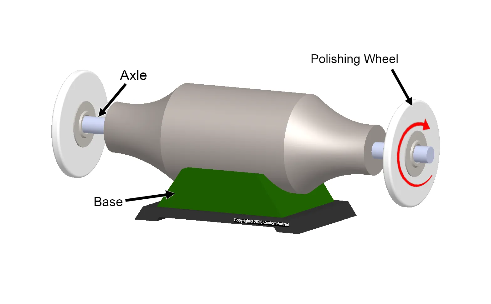

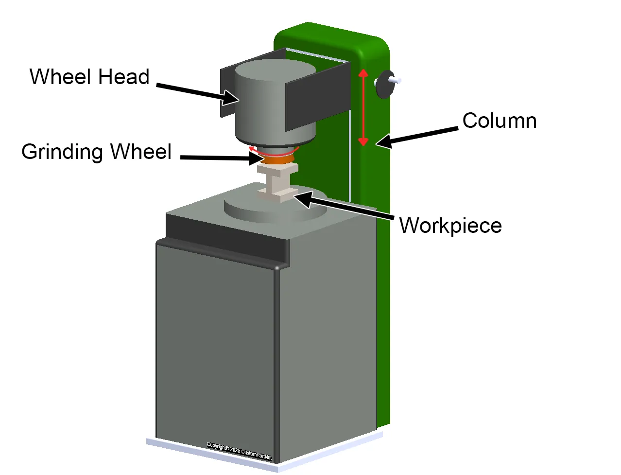

  • Cylindrical or rotary surface grinders
  • Buffing/polishing compounds and wheels
  • Abrasive belt machines

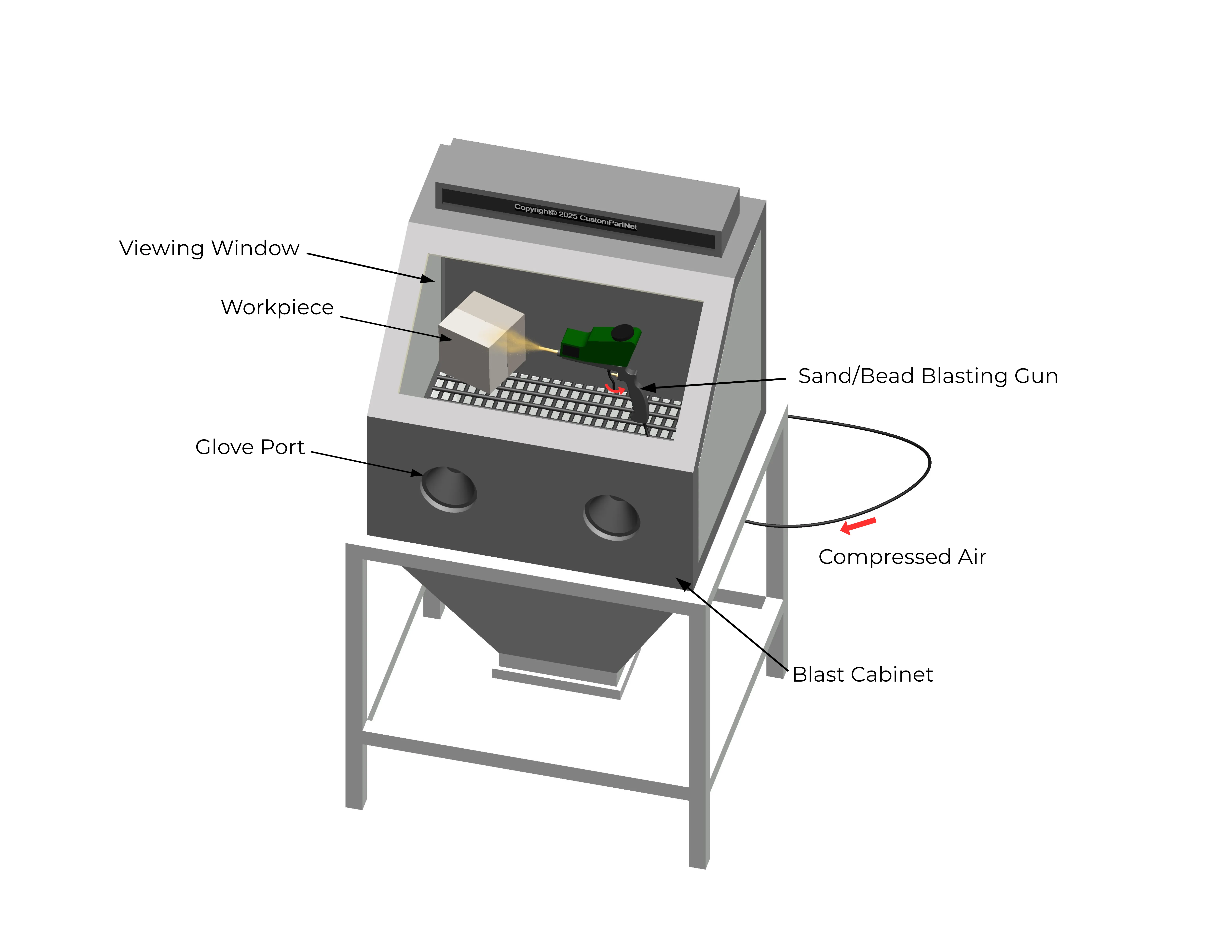

  • Sandblast pressure systems and cabinets
  • Ultrasonic cleaners (for end-of-process cleaning)
