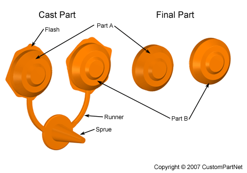

  5. Trimming - During cooling, the material in the channels of the die will solidify attached to the casting. This excess material, along with any flash that has occurred, must be trimmed from the casting either manually via cutting or sawing, or using a trimming press. The time required to trim the excess material can be estimated from the size of the casting's envelope. The scrap material that results from this trimming is either discarded or can be reused in the die casting process. Recycled material may need to be reconditioned to the proper chemical composition before it can be combined with non-recycled metal and reused in the die casting process.
Die cast part
Die cast part

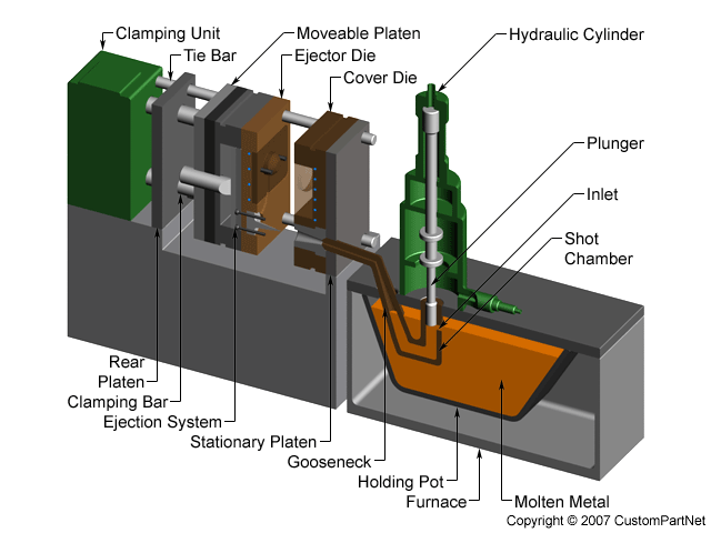

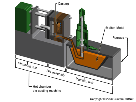

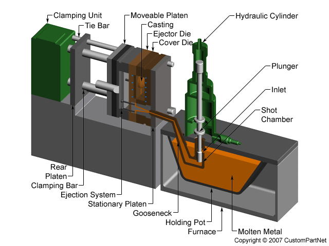

The two types of die casting machines are a hot chamber machine and cold chamber machine.
  • Hot chamber die casting machine - Hot chamber machines are used for alloys with low melting temperatures, such as zinc, tin, and lead. The temperatures required to melt other alloys would damage the pump, which is in direct contact with the molten metal. The metal is contained in an open holding pot which is placed into a furnace, where it is melted to the necessary temperature. The molten metal then flows into a shot chamber through an inlet and a plunger, powered by hydraulic pressure, forces the molten metal through a gooseneck channel and into the die. Typical injection pressures for a hot chamber die casting machine are between 1000 and 5000 psi. After the molten metal has been injected into the die cavity, the plunger remains down, holding the pressure while the casting solidifies. After solidification, the hydraulic system retracts the plunger and the part can be ejected by the clamping unit. Prior to the injection of the molten metal, this unit closes and clamps the two halves of the die. When the die is attached to the die casting machine, each half is fixed to a large plate, called a platen. The front half of the die, called the cover die, is mounted to a stationary platen and aligns with the gooseneck channel. The rear half of the die, called the ejector die, is mounted to a movable platen, which slides along the tie bars. The hydraulically powered clamping unit actuates clamping bars that push this platen towards the cover die and exert enough pressure to keep it closed while the molten metal is injected. Following the solidification of the metal inside the die cavity, the clamping unit releases the die halves and simultaneously causes the ejection system to push the casting out of the open cavity. The die can then be closed for the next injection.
Hot chamber machine open
Hot chamber die casting machine - Opened
Hot chamber machine closed
Hot chamber die casting machine - Closed

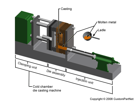

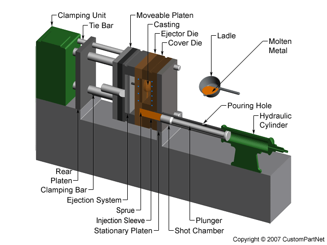

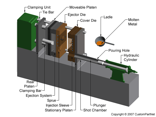

  • Cold chamber die casting machine - Cold chamber machines are used for alloys with high melting temperatures that can not be cast in hot chamber machines because they would damage the pumping system. Such alloys include aluminum, brass, and magnesium. The molten metal is still contained in an open holding pot which is placed into a furnace, where it is melted to the necessary temperature. However, this holding pot is kept separate from the die casting machine and the molten metal is ladled from the pot for each casting, rather than being pumped. The metal is poured from the ladle into the shot chamber through a pouring hole. The injection system in a cold chamber machine functions similarly to that of a hot chamber machine, however it is usually oriented horizontally and does not include a gooseneck channel. A plunger, powered by hydraulic pressure, forces the molten metal through the shot chamber and into the injection sleeve in the die. The typical injection pressures for a cold chamber die casting machine are between 2000 and 20000 psi. After the molten metal has been injected into the die cavity, the plunger remains forward, holding the pressure while the casting solidifies. After solidification, the hydraulic system retracts the plunger and the part can be ejected by the clamping unit. The clamping unit and mounting of the dies is identical to the hot chamber machine. See the above paragraph for details.
Cold chamber die casting machine open
Cold chamber die casting machine - Opened
Cold chamber die casting machine closed
Cold chamber die casting machine - Closed

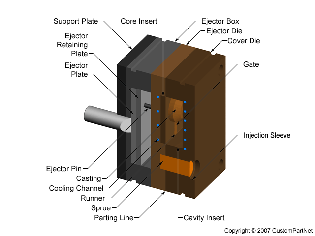

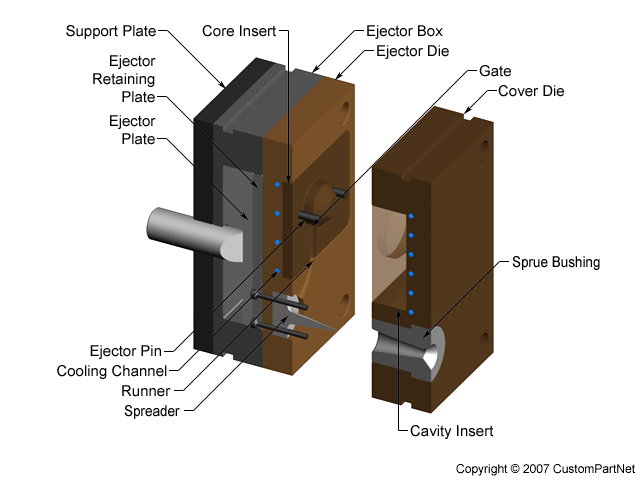

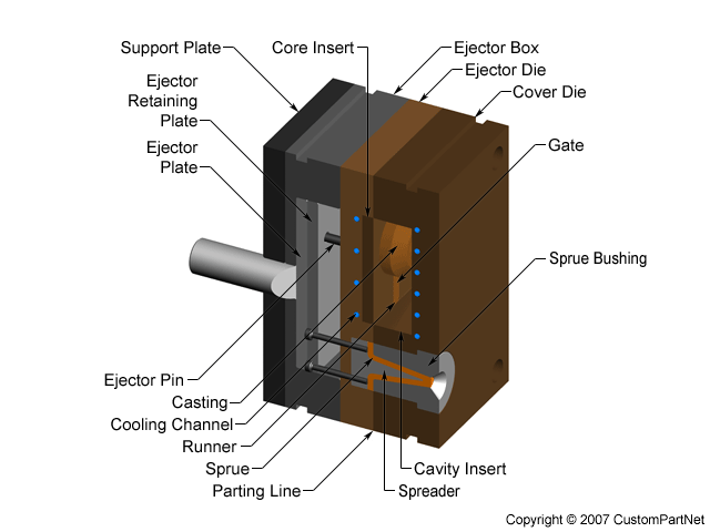

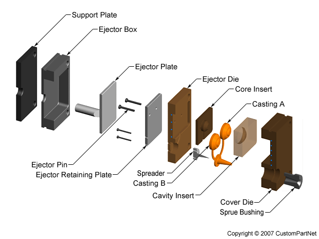

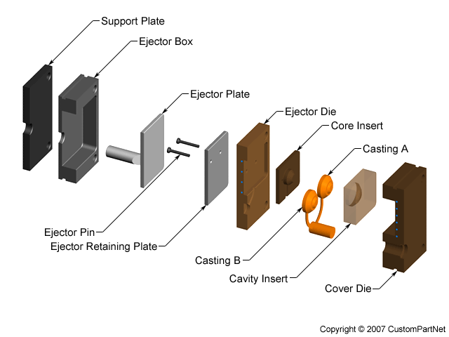

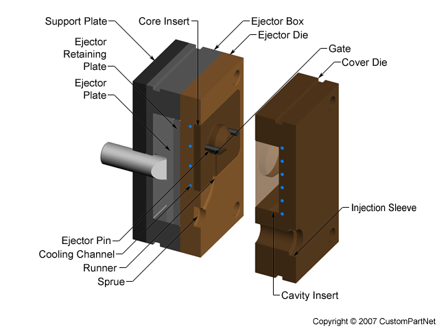

The dies into which the molten metal is injected are the custom tooling used in this process. The dies are typically composed of two halves - the cover die, which is mounted onto a stationary platen, and the ejector die, which is mounted onto a movable platen. This design allows the die to open and close along its parting line. Once closed, the two die halves form an internal part cavity which is filled with the molten metal to form the casting. This cavity is formed by two inserts, the cavity insert and the core insert, which are inserted into the cover die and ejector die, respectively. The cover die allows the molten metal to flow from the injection system, through an opening, and into the part cavity. The ejector die includes a support plate and the ejector box, which is mounted onto the platen and inside contains the ejection system. When the clamping unit separates the die halves, the clamping bar pushes the ejector plate forward inside the ejector box which pushes the ejector pins into the molded part, ejecting it from the core insert. Multiple-cavity dies are sometimes used, in which the two die halves form several identical part cavities.
Die channels
The flow of molten metal into the part cavity requires several channels that are integrated into the die and differs slightly for a hot chamber machine and a cold chamber machine. In a hot chamber machine, the molten metal enters the die through a piece called a sprue bushing (in the cover die) and flows around the sprue spreader (in the ejector die). The sprue refers to this primary channel of molten metal entering the die. In a cold chamber machine, the molten metal enters through an injection sleeve. After entering the die, in either type of machine, the molten metal flows through a series of runners and enters the part cavities through gates, which direct the flow. Often, the cavities will contain extra space called overflow wells, which provide an additional source of molten metal during solidification. When the casting cools, the molten metal will shrink and additional material is needed. Lastly, small channels are included that run from the cavity to the exterior of the die. These channels act as venting holes to allow air to escape the die cavity. The molten metal that flows through all of these channels will solidify attached to the casting and must be separated from the part after it is ejected. One type of channel that does not fill with material is a cooling channel. These channels allow water or oil to flow through the die, adjacent to the cavity, and remove heat from the die.
Hot chamber die open
Die assembly - Open
(Hot chamber)
Hot chamber die closed
Die assembly - Closed
(Hot chamber)

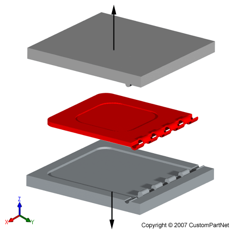

Hot chamber die exploded
Die assembly - Exploded view
(Hot chamber)
Cold chamber die open
Die assembly - Opened
(Cold chamber)
Cold chamber die closed
(Cold chamber)
Cold chamber die exploded
(Cold chamber)

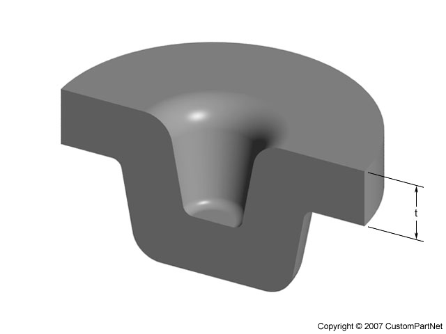

Maximum wall thickness
  • Decrease the maximum wall thickness of a part to shorten the cycle time (injection time and cooling time specifically) and reduce the part volume
INCORRECT
Part with thick walls
CORRECT
Part redesigned with thin walls

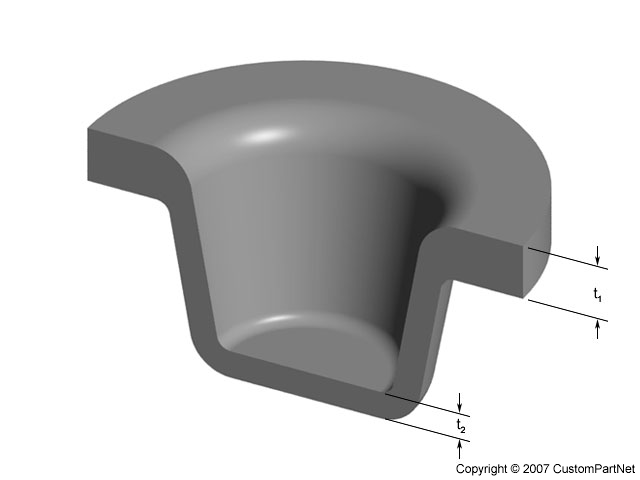

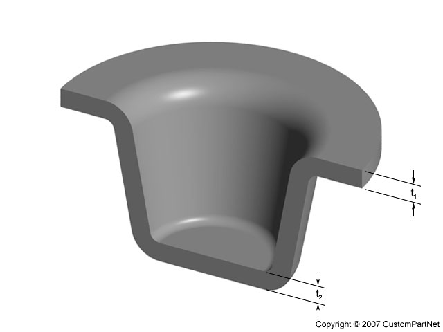

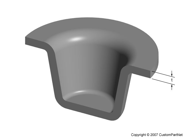

  • Uniform wall thickness will ensure uniform cooling and reduce defects
INCORRECT
Non-uniform wall thickness
Non-uniform wall thickness (t₁ ≠ t₂)
CORRECT
Uniform wall thickness (t₁ = t₂)

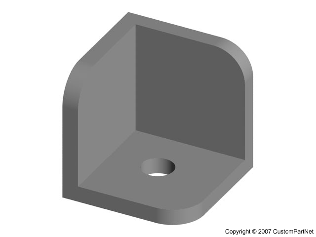

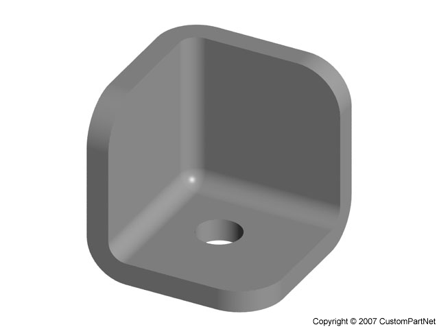

Corners
  • Round corners to reduce stress concentrations and fracture
  • Inner radius should be at least the thickness of the walls
INCORRECT
Sharp corner
Sharp corner
CORRECT
Rounded corner
Rounded corner

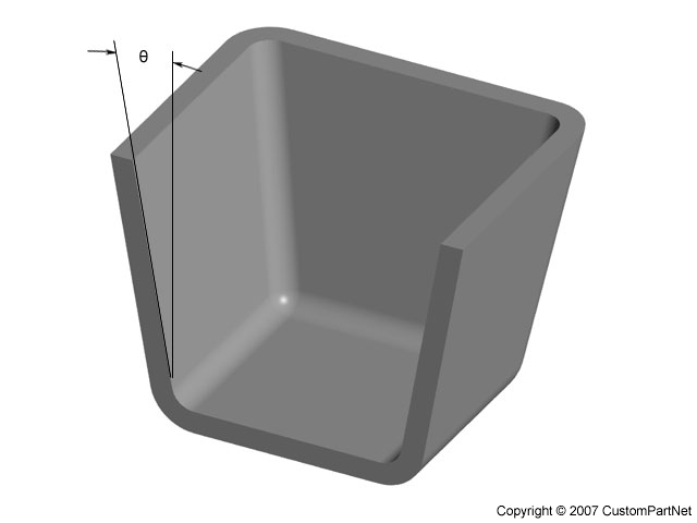

Draft
  • Apply a draft angle to all walls parallel to the parting direction to facilitate removing the part from the die.
    • Aluminum: 1° for walls, 2° for inside cores
    • Magnesium: 0.75° for walls, 1.5° for inside cores
    • Zinc: 0.5° for walls, 1° for inside cores
INCORRECT
No Draft Angle
No draft angle
CORRECT
Draft Angle
Draft angle (θ)

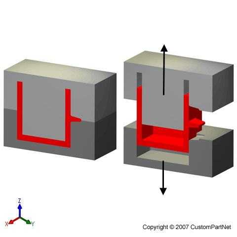

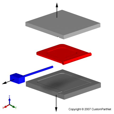

Undercuts
  • Minimize the number of external undercuts
    • External undercuts require side-cores which add to the tooling cost
    • Some simple external undercuts can be cast by relocating the parting line

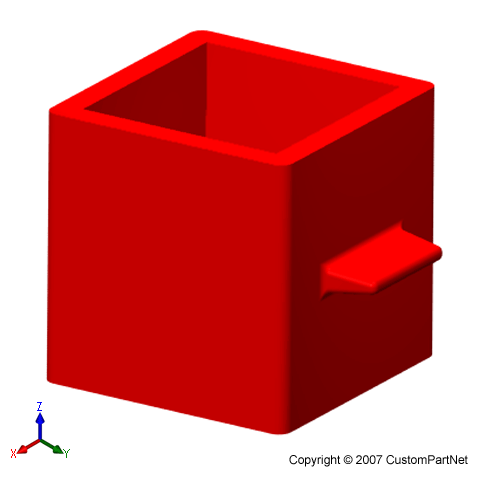

Simple external undercut
Die cannot separate
Die cannot separate
New parting line allows undercut

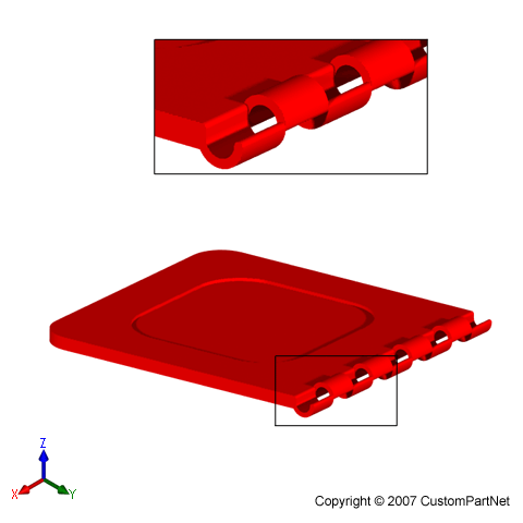

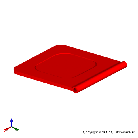

  • Redesigning a feature can remove an external undercut
Part with hinge
Part with hinge
Hinge requires side-core
Redesigned hinge
Redesigned hinge
New hinge can be cast

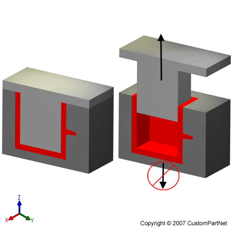

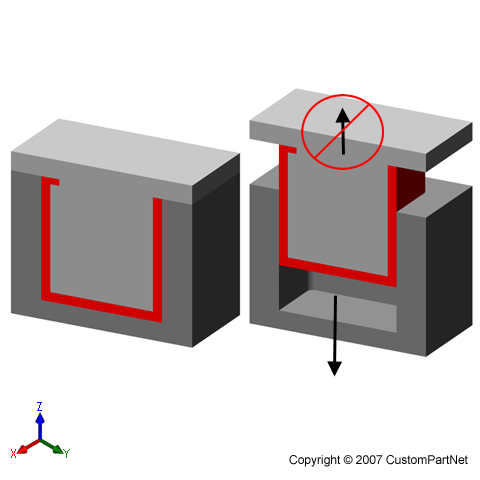

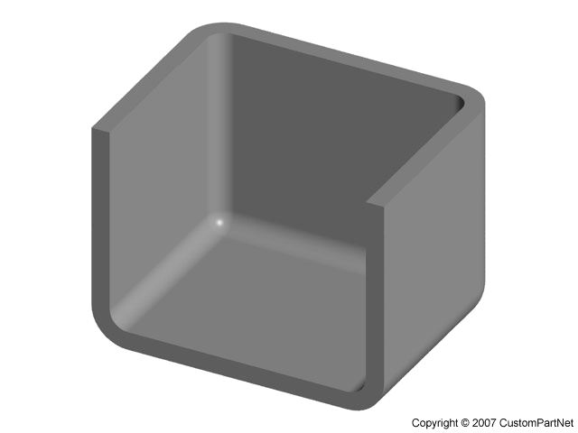

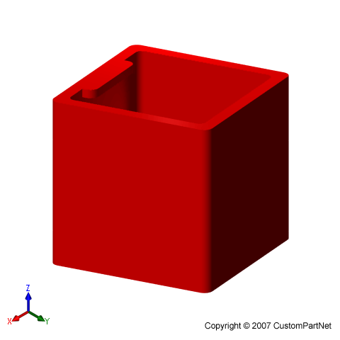

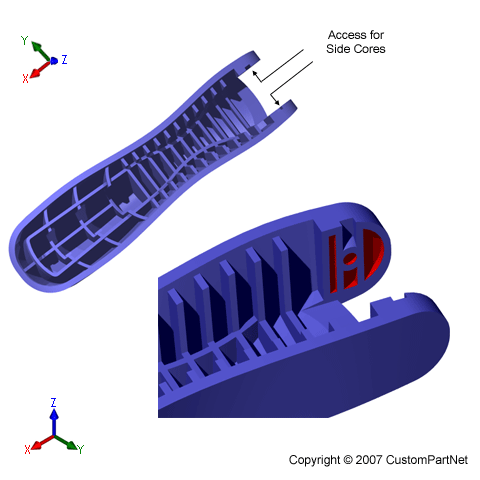

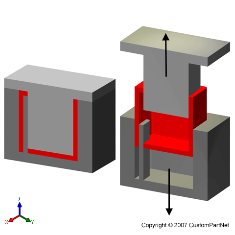

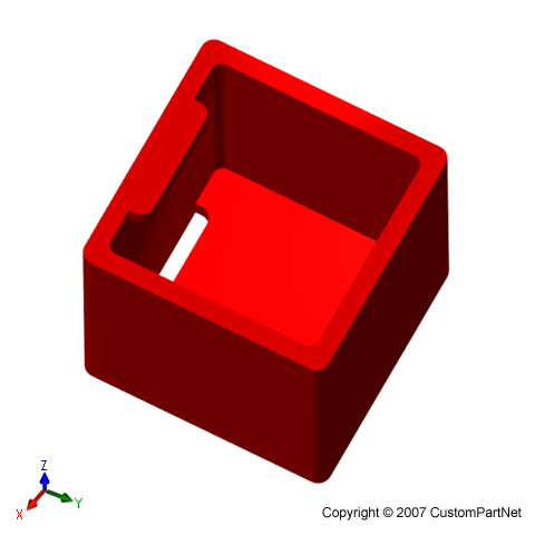

  • Remove all internal undercuts that require lifters - Jamming of these devices often occurs in die casting
    • Designing an opening in the side of a part can allow a side-core to form an internal undercut
Internal undercut accessible from the side
  • Redesigning a part can remove an internal undercut
Part with internal undercut
Die cannot separate
Die cannot separate
Part redesigned with slot
New part can be cast
