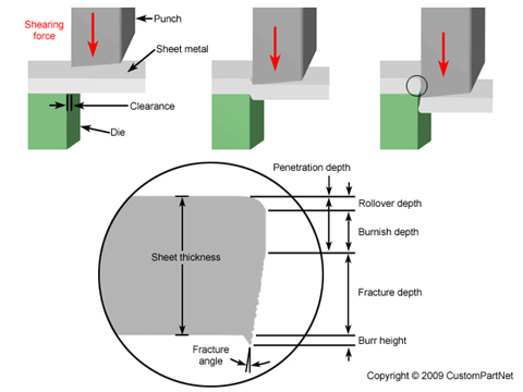

The effects of shearing on the material change as the cut progresses and are visible on the edge of the sheared material. When the punch or blade impacts the sheet, the clearance between the tools allows the sheet to plastically deform and "rollover" the edge. As the tool penetrates the sheet further, the shearing results in a vertical burnished zone of material. Finally, the shear stress is too great and the material fractures at an angle with a small burr formed at the edge. The height of each of these portions of the cut depends on several factors, including the sharpness of the tools and the clearance between the tools.

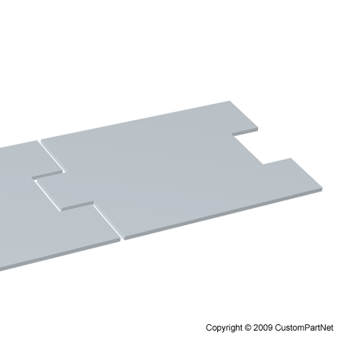

As mentioned above, several cutting processes exist that utilize shearing force to cut sheet metal. However, the term "shearing" by itself refers to a specific cutting process that produces straight line cuts to separate a piece of sheet metal. Most commonly, shearing is used to cut a sheet parallel to an existing edge which is held square, but angled cuts can be made as well. For this reason, shearing is primarily used to cut sheet stock into smaller sizes in preparation for other processes. Shearing has the following capabilities:
  • Sheet thickness: 0.005-0.25 inches
  • Tolerance: ±0.1 inches (±0.005 inches feasible)
  • Surface finish: 250-1000 μin (125-2000 μin feasible)
The shearing process is performed on a shear machine, often called a squaring shear or power shear, that can be operated manually (by hand or foot) or by hydraulic, pneumatic, or electric power. A typical shear machine includes a table with support arms to hold the sheet, stops or guides to secure the sheet, upper and lower straight-edge blades, and a gauging device to precisely position the sheet. The sheet is placed between the upper and lower blade, which are then forced together against the sheet, cutting the material. In most devices, the lower blade remains stationary while the upper blade is forced downward. The upper blade is slightly offset from the lower blade, approximately 5-10% of the sheet thickness. Also, the upper blade is usually angled so that the cut progresses from one end to the other, thus reducing the required force. The blades used in these machines typically have a square edge rather than a knife-edge and are available in different materials, such as low alloy steel and high-carbon steel.

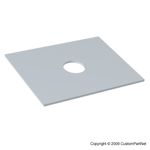

A typical punching operation is one in which a cylindrical punch tool pierces the sheet metal, forming a single hole. However, a variety of operations are possible to form different features. These operations include the following:
  • Piercing - The typical punching operation, in which a cylindrical punch pierces a hole into the sheet.

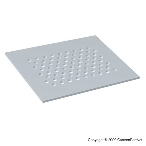

  • Perforating - Punching a close arrangement of a large number of holes in a single operation.

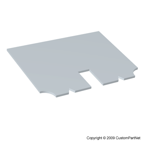

  • Notching - Punching the edge of a sheet, forming a notch in the shape of a portion of the punch.
Notching

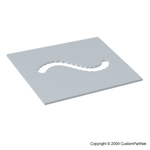

  • Nibbling - Punching a series of small overlapping slits or holes along a path to cutout a larger contoured shape. This eliminates the need for a custom punch and die but will require secondary operations to improve the accuracy and finish of the feature.

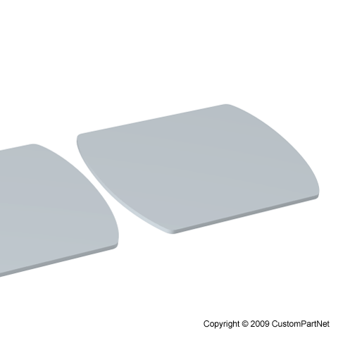

  • Cutoff - Separating a part from the remaining sheet, without producing any scrap. The punch will produce a cut line that may be straight, angled, or curved.
