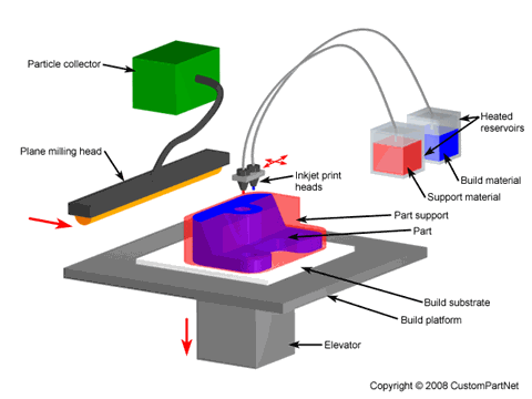

The inkjet printing process, as
implemented by Solidscape Inc., begins with the build
material (thermoplastic) and support material (wax)
being held in a melted state inside two heated
reservoirs. These materials are each fed to an inkjet
print head which moves in the X-Y plane and shoots tiny
droplets to the required locations to form one layer of
the part. Both the build material and support material
instantly cool and solidify. After a layer has been
completed, a milling head moves across the layer to
smooth the surface. The particles resulting from this
cutting operation are vacuumed away by the particle
collector. The elevator then lowers the build platform
and part so that the next layer can be built. After this
process is repeated for each layer and the part is
complete, the part can be removed and the wax support
material can be melted away.
