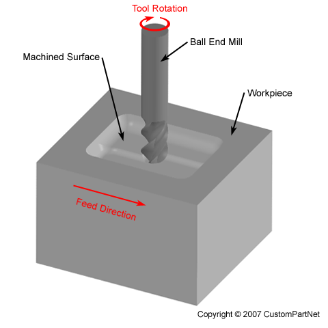

End milling
An operation in which an end mill makes either peripheral or slot cuts across the workpiece, determined by the step-over distance, in order to machine a specified feature. The depth of the feature may be machined in a single pass or may be reached by machining at a smaller axial depth of cut and making multiple passes. For a rough operation, the recommended cutting speed and feed are selected for a peripheral or slot cut. A finish operation will lower the cutting feed according to the finish requirements.
End milling - End milling (Profile)
End milling - End milling (Slot)
End milling (Slot)
End milling - End milling (Pocket)

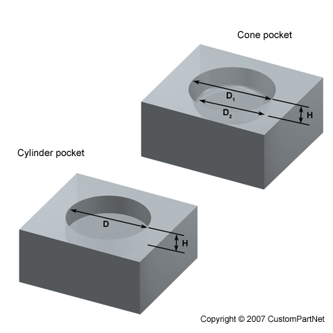

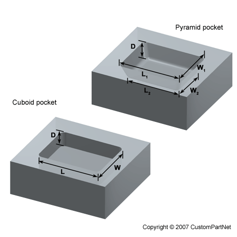

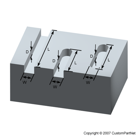

End milling features
An end milling operation can produce a variety of features, including profiles, slots, and pockets. A profile is a peripheral cut along an external or internal edge of the workpiece with a length equal to the complete perimeter, just one side, or even a part of a side. A slot is a slot cut in the workpiece that can form a complete loop, run through two sides, run through one side, or be contained. Profiles and slots can be machined with multiple steps and by following straight or curved paths. A pocket is a contained feature of any shape that can be machined by either peripheral or slot cuts. Four possible pocket shapes include a cuboid, pyramid, cylinder, and cone. An end milling operation is capable of producing any custom shape, however the total cut length must be known in order to estimate the cost.

End milling features - Slot: Through (2 sides, 1 side, 0 sides)
End milling features - Pocket: Cuboid, Pyramid
End milling features - Pocket: Cylinder, Cone

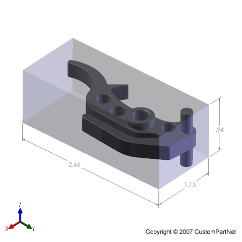

Envelope
The smallest box, sometimes called a bounding box, that is able to contain the part. The X-Y-Z dimensions of this box describe the maximum length, width, and height of the part. In molding processes, the Z-axis (describing the part's height) is the parting direction of the mold.

Envelope - Trigger (1.13 x 2.66 x 0.94)
Trigger

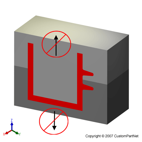

External undercut
A feature on the exterior of a part that will not allow a mold that contains it to slide away along the parting direction. An external undercut can be either a protrusion or a depression (hole or pocket) and requires an additional mold piece called a side-core to form its shape.
External undercut - Part with external protrusion
External undercut - Mold cannot separate
External undercut - Part with external hole
