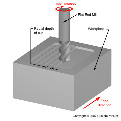

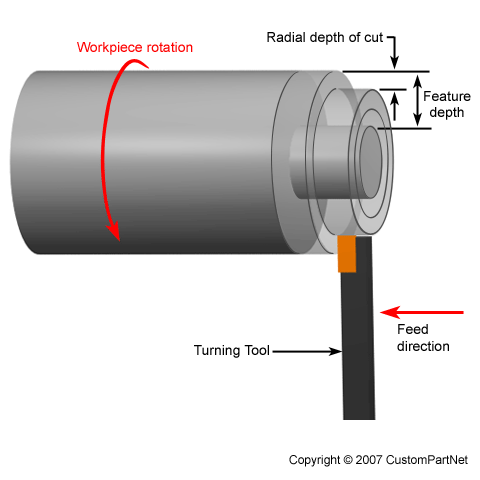

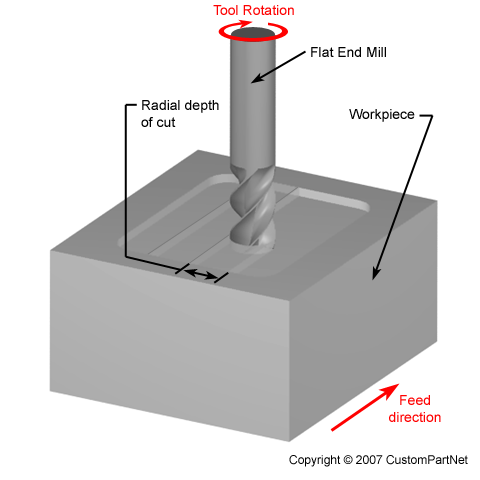

Radial depth of cut
The depth of the tool along its radius in the workpiece as it makes a cut. If the radial depth of cut is less than the tool radius, the tool is only partially engaged and is making a peripheral cut. If the radial depth of cut is equal to the tool diameter, the cutting tool is fully engaged and is making a slot cut. In turning and boring operations, a single-point tool cuts at a depth relative to the workpiece radius. A large radial depth of cut will require a low feed rate, or else it will result in a high load on the tool and reduce the tool life. Therefore, a feature is often machined in several steps as the tool moves over the step-over distance, and makes another cut at the radial depth of cut.
Radial depth of cut - Milling (Peripheral cut)
Radial depth of cut - Milling (Slot cut)
Milling (Slot cut)
Radial depth of cut - Turning
Turning

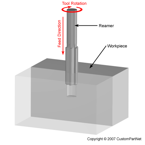

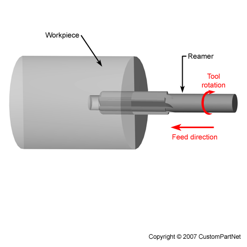

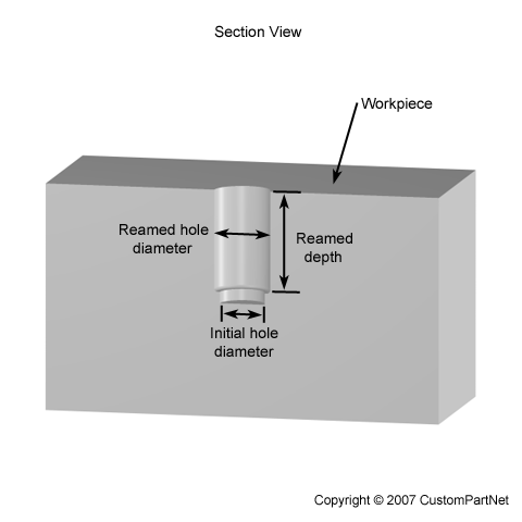

Reaming
An operation in which a reamer enters the workpiece axially and enlarges an existing hole to the diameter of the tool. Reaming removes a minimal amount of material and is often performed after drilling to obtain both a more accurate diameter and a smoother internal finish. A finish reaming operation will use a slower cutting feed and cutting speed to provide an even better finish.
Reaming - Reaming (Milling machine)
Reaming - Reaming (Turning machine)
Reaming - Reamed hole
Reamed hole
