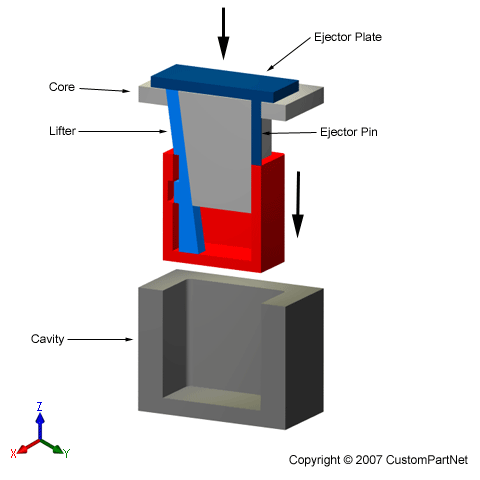

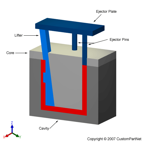

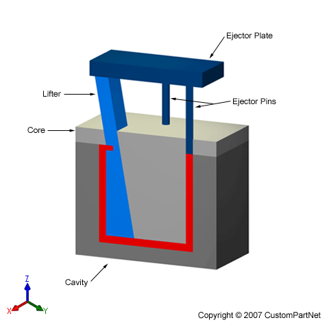

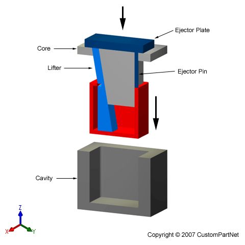

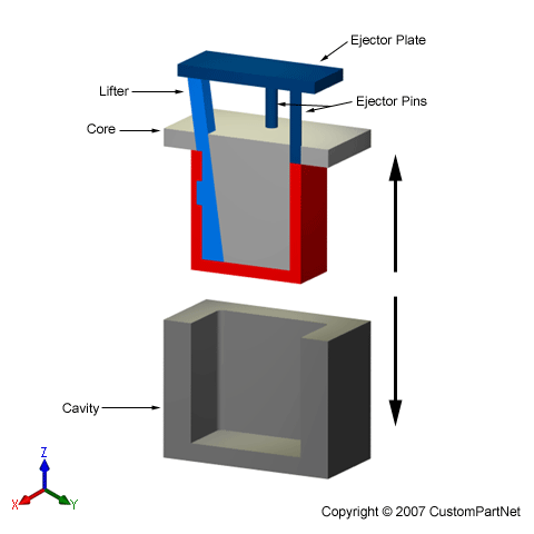

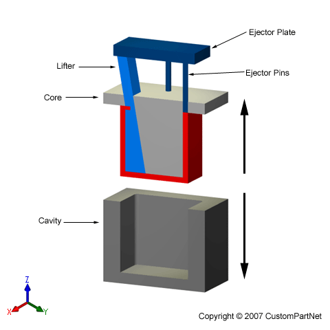

Internal core lifter
An additional mold piece that is used to form an internal undercut that cannot be accessed from the side of the part. Unlike a side-core, an internal core lifter enters the mold along the parting direction, not through the side, and is actuated by the ejection system.
Internal core lifter - Molding an internal protrusion - Step 1
Internal core lifter - Molding an internal protrusion - Step 2
Internal core lifter - Molding an internal protrusion - Step 3
Internal core lifter - Molding an internal hole - Step 1
Internal core lifter - Molding an internal hole - Step 2
Internal core lifter - Molding an internal hole - Step 3

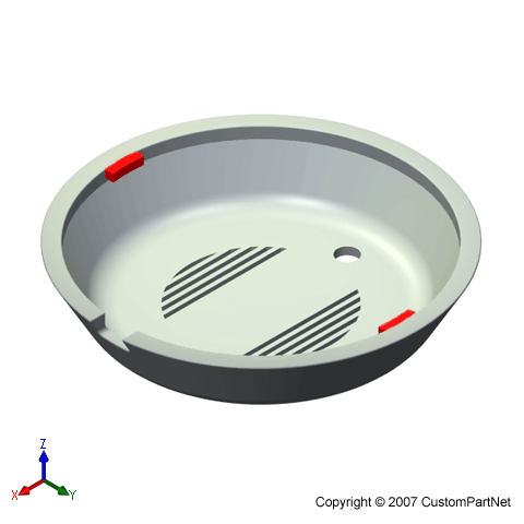

Internal core lifter - Internal undercuts requiring lifters

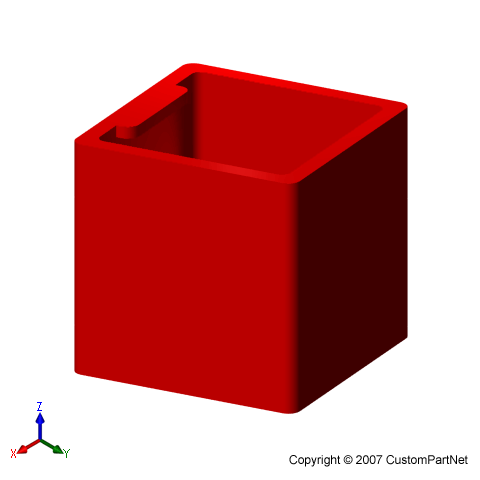

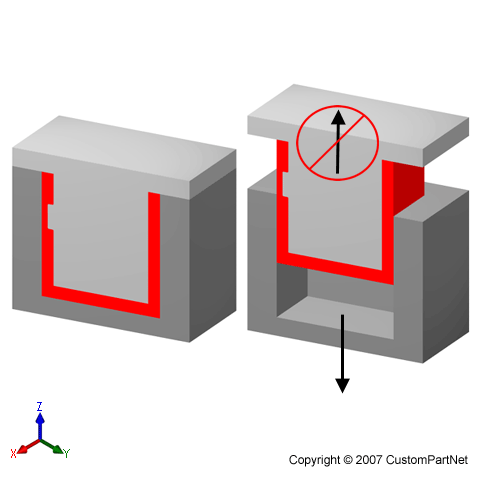

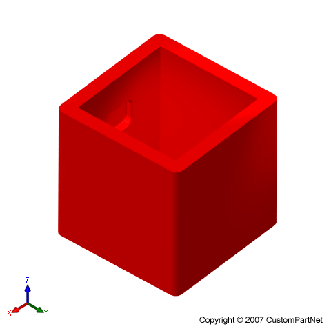

Internal undercut
A feature on the interior of a part that will not allow a mold that contains it to slide away along the parting direction. An internal undercut can be either a protrusion or a depression (hole or pocket) and requires an additional mold piece to form its shape. Most internal undercuts require an internal core lifter. However, if the feature can be accessed through an open side of the part, a side-core can be used.
Internal undercut - Part with internal protrusion
Internal undercut - Mold cannot separate
