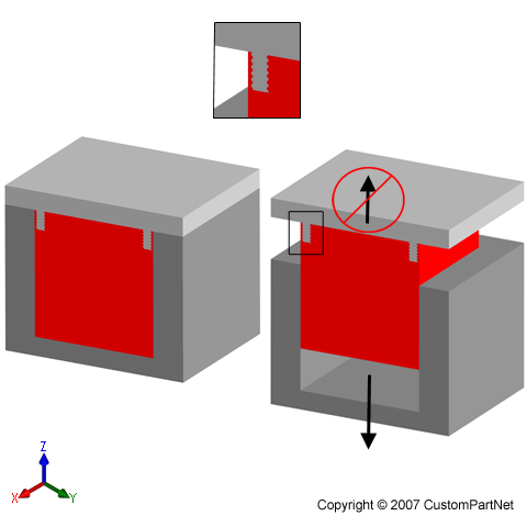

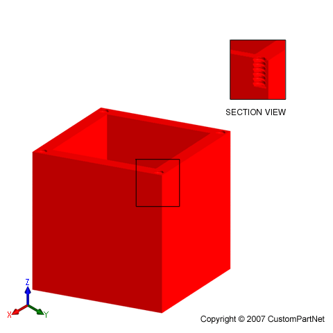

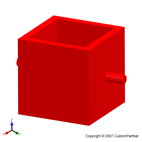

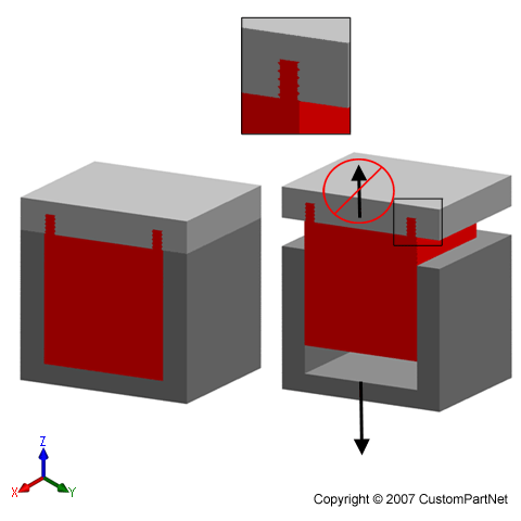

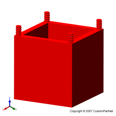

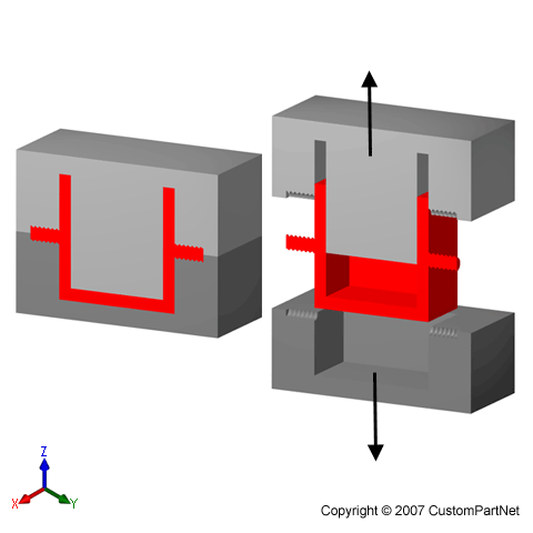

Unscrewing device
An additional mold piece that is used to form threaded features (internal or external). External threads on a feature perpendicular to the parting direction can be formed by the two mold halves. However, other external threads and all internal threads require an unscrewing device. The device is inserted into the mold to allow the threaded feature to form and is then unscrewed to be removed.
Unscrewing device - External threads on Y axis
Unscrewing device - Mold can form threads
Unscrewing device - External threads on Z axis
Unscrewing device - Mold cannot separate
Unscrewing device - Internal threads
Internal threads
