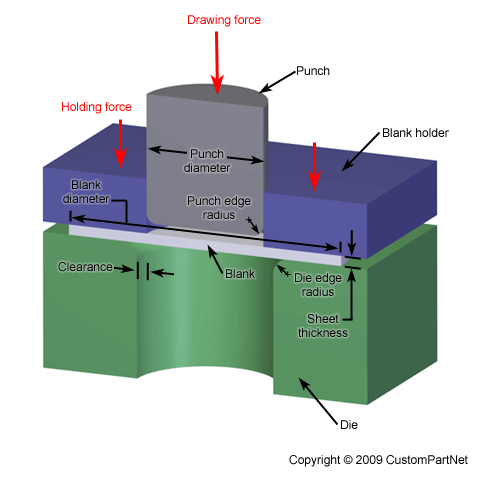

Deep drawing force
The amount of force required to deep draw a sheet metal blank to a smaller diameter determined by the punch. The required force will depend upon the material, sheet thickness, and drawing ratio. The drawing force will create enough stress in the material to exceed the tensile yield strength, allowing the material to plastically deform to the new shape.
Deep drawing force - Deep drawing
Deep drawing

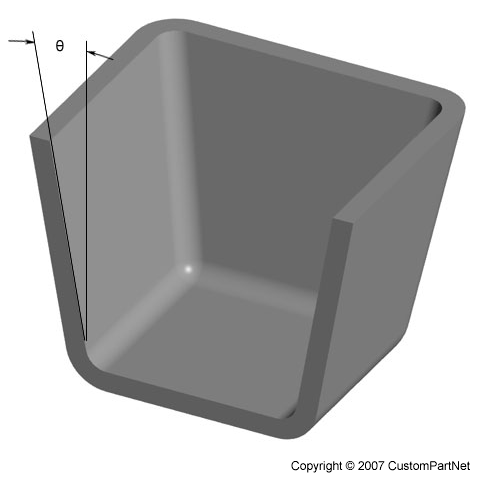

Draft
The offset of the walls of a part by a slight angle, referred to as the draft angle. A draft angle is often required on the surfaces of a part that are parallel to the tooling direction in order to facilitate removal from a mold. However, some processes do not require a part to have any draft.
Draft - Draft angle
Draft angle

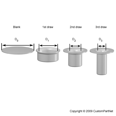

Draw reduction
The percent reduction of the diameter of a sheet metal blank to the draw diameter (or punch diameter) through a deep drawing operation. The complete deep drawing of a part is often achieved by a series of draw reductions.
Draw reduction - Deep drawing reduction

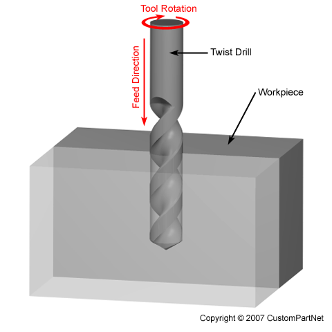

Drilling
An operation in which a drill enters the workpiece axially and cuts a hole with a diameter equal to that of the tool. On a milling machine, an end milling operation is required to produce a hole with a tool smaller than the hole diameter. A drilling operation typically produces a blind hole, which extends to some depth inside the workpiece, measured to the point made by the tool or to the end of the full diameter portion. On a milling machine, a hole that extends completely through the workpiece (through hole) can also be drilled.
Drilling - Drilling (Milling machine)

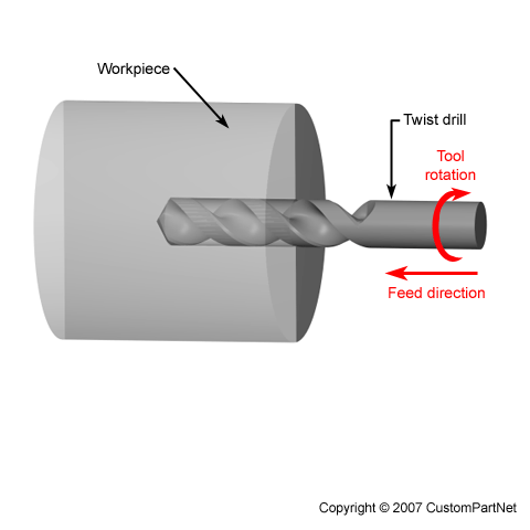

Drilling - Drilling (Turning machine)

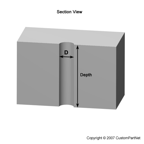

Drilling - Blind hole
Blind hole
