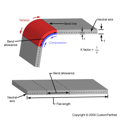

In bending, the k-factor defines the location of the neutral axis in the material and is dependent upon several factors, such as the material, bending operation, bend angle, etc. The k-factor is calculated as the ratio of the distance of the neutral axis (measured from the inside bend surface) to the material thickness. Values for the k-factor are typically greater than 0.25 and cannot exceed 0.50.
K-factor - Neutral axis
Neutral axis

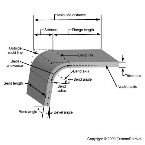

K-factor - Bending diagram
Bending diagram
